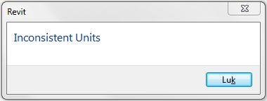

    Whilst searching the forums trying to get my head around why Revit is always telling me I have inconsistent units in the calculated values in my schedules, I came across this little beauty on the Revit Forum

    ....."Inconsistent Units ! Probably THE error box in Revit that have caused me the most grief, over the years I´ve spent hours and hours on trying to work around it. But once I got the hang of it, and not least once I understood WHY Revit would throw that error box at me, it´s not that bad. Hope some of you will find this helpful.

    So if you have a Length parameter, and try to use a (Length * Length) formula, you´ll get the " Inconsistent Units" error, because (Length * Length = Length Squared). Only way around is to neutralize the units on at least one of the parameters in the formula. The easiest way to neutralize a unit is by dividing by 1 (one):
