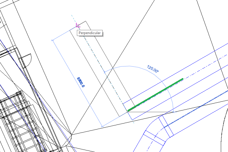

    hello
    i'd like to know if there's a way to change the angle of the pipe when i'm creating it
    in the example below the angle is 90° from the pipe but the value is measured to a horizontal line...
    is it possible to change the line which the angle is measured? the green is this example will be the best one
    thanks

    Hello,
    I know two ways:
    1. Rotate a copy of the reference pipe segment.
    2. Continue (lengthen) the reference pipe with a small segment first, then make a turn (the angle will be measured from the previous pipe segment).
