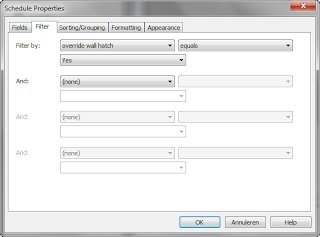

    Go to Filter tab > Add a filter and filter on "override existing hatch" to equal Yes, see image 13.
    This way you are showing all Walls created in Phase New which have the "override existing hatch" applied (which is wrong, since these walls are New).
