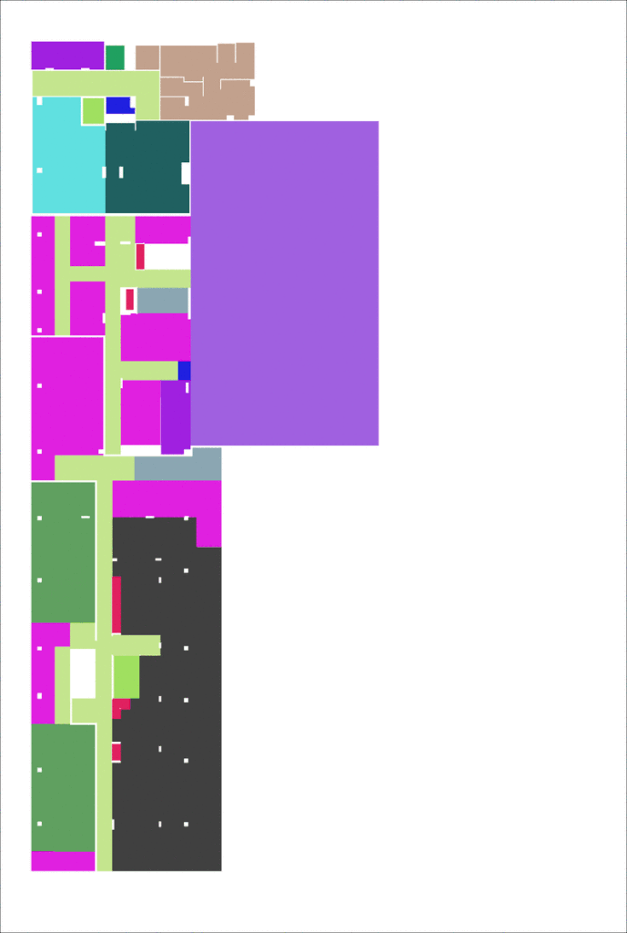

            #6
            ...but I do use Rooms to make these
              #7
              Snowy, I think this is a great example of what Rooms (Or Spaces for MEP) are for... to contain and visualise data.
              People are always saying "Revit is not CAD it is a database" but how many of us actually use it as one for all our project data? I see the value of creating a good rooms model is that it is the container for all the project specifications and requirements that are usually contained in all kinds of useless hand sketches, excel, word or marked up pdf drawings that you cant easily do any analysis with.
              Occupancy is a good example of how the room model provides the link between a general specification and the actual 3D model, and is how we work for all kinds of things in MEP models. You get a basic requirement that is specified per m2, m3 or per person, that is linked to a particular room function (Eg. with a key schedule) and you only have to define what the function of the rooms are for this to be calculated to the actual area or volume.
              Then you can easily visualise the results and make design decisions without actually modelling anything. Managers are always complaining about how BIM is an extra cost because it takes so much work to show everything on drawings, but I think this is mostly because of the expectation that the actual components have to be visible and tagged on drawings. If you can communicate a design concept using purely colour plans and figures, with very little work, thats a massive win compared to modelling things before a decision can be made and then re-modelling.
              Finally, when you have made your 3D model, how do you know it is correct? How can you show if the furniture, finishes, lighting, ventilation etc is correct and meets the design requirements? If you have all the design requirements in the rooms model, updated to the latest areas, it is utterly trivial to check this. Compared to the traditional alternative of someone printing out the drawings, peering at them to visually check against a list, scribbling on them in illegible red pen and expecting them to be re-worked, this can also save a massive waste of time.
              So I am personally all for modelling Building Information instead of stuff in 3D. However, as MEP engineers we are totally dependent on getting an architectural model from which the Number, Name and Function of a room can be easily imported for us to attach all our data to. You wont believe how many models I have seen with no rooms at all (Areas?), non-unique room numbers (!) or slightly different spelling of all the rooms that actually have the same function.
              For many architects their experience of MEP engineers is probably constant moaning about how unexpected changes have given them lots of extra work to do , but give a thought to how the info will be used by others, so the movement or change of function of a room can be picked up automatically, and they will be happier :thumbsup:.
