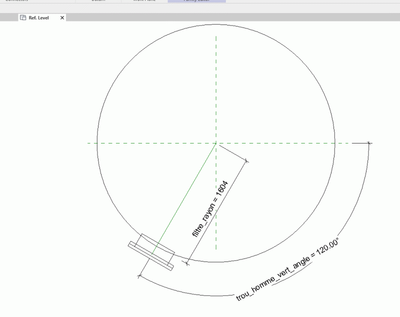

why does the dimension change?
    hello
    i have a family on which i have an angle on a reference line
    a nested family is locked to this reference line, when i change the angle, the ref.line moves but...
    why does the length "filtre_rayon" changes too
    this parameters is only link to another parameter (filtre_diametre) so it shouldn't change when angle is changing!
    i think that's a question snaps of the dimension or something like this but i clean the file (delete the family nested, the line...) create a new ref line but the issue is still there
    do you know why?

    What is the left end of the filtre_rayon dimension attached to?

      i have a look to the old family that i made, i have exactly the same problem : changing the angle modify the radius of the tank (it's a family tank)
      in others words how can I create a nested family that i can control with an angle and with a specific length from the center of the family?

        got it
        i needed to create a rel line more which is 90° from the fisrt one (which control the angle)
        the ref line w<ill be attached to the dimension and it will work!!
