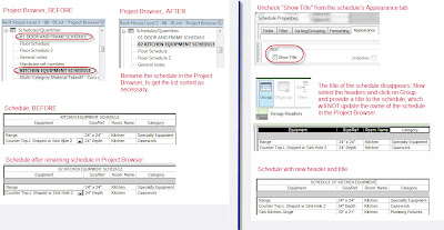

    Brief comment about the first post:
    In this contribution, Steve Stafford, from Revit OpEd , provides a trick to overcome the limitations of the Browser Organization features in regards to sorting schedules. We can sort other views easily, by type or discipline, or by new parameters, but this is not possible for schedules. Therefore, the proposed solution is this: Rename the schedules in the Project Browser as necessary in order to create a sorted list, as per your needs. Since the new name will immediately change the title of the schedule on the sheet, then go to the Appearance tab of the schedule and turn off the Show Title option. Then group the columns of the schedule to create an overall header. Provide a name for the header, to work as the title of the schedule. This new “title” will not affect the sorted list that you have already created in the Project Browser.
    For more information, please refer to Post #30573 at Revitforum.org , and to this article in Steve’s blog.

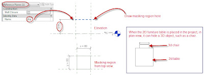

    Brief comment about the second post:
    In this post, Alex Page, from RevitWorks Ltd, explains a technique to create Revit furniture families in 2D that will still obscure other objects, by using masking regions hosted at reference planes at the required elevation.
    For more information, please refer to Post #30920 at Revitforum.org.
