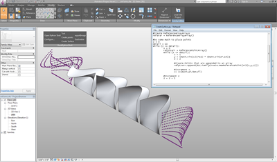

    It’s here! Daren Thomas has posted installers for RevitPythonShell for BOTH Revit 2012 and Vasari 2.1.
    What does this mean?  You, dear reader, can now script live in a Vasari session using Python.  Behold!

    The samples I’m showing are things that I am not capable of cobbling together on my own . . . I’m NOT AT ALL a coding person.   It’s actually my desperate hope that you will understand there concepts much better than I and do something cool with the tools. Keep an eye on Nathan Miller’s site, I’m sure he will have good stuff.   My Create Surface script is a simplification of his supershapes script posted here. Thanks to Aki Hogge for everything else.

    To monkey with the scripts live, just open them in an editor (notepad works, I’m sure there are way better ones) make changes, save and then run again in Vasari.
