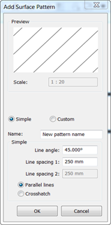

    You can also create your own fill patterns directly in Revit, however you are limited to creating patterns which are either parallel lines or cross hatch.

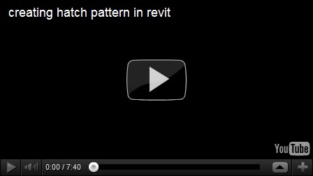

    Nether the less, architects are generally visual people, we draw & design; very few of us can write scripts & code! So this is where Hatch Kit Pro steps in. Its a $125 utility for creating hatch patterns & is well worth the money and it will save you hours of pain! Patterns can be created directly in the Hatch Kit Pro or imported as a DXF from say Revit or AutoCAD & then exported to generate the .PAT file. The following video steps through what I think is the quickest process for creating that pattern you have always wanted!
