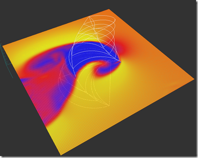

    This is what I get after only a few seconds using the default settings on my model.
    Now, this is fine, it gives you a good starting point to understanding your model.  But with my corkscrewing geometry, I’m pretty sure that I’m getting a vigorous 3 dimensional churn, probably a big rush of wind coming up from the innocent victim trap plaza.  To take this into account, you need to check the 3D Analysis button.

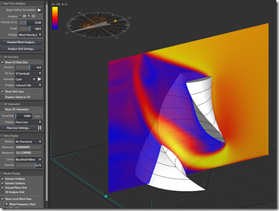

    This is where you will jump from “real time” to something more intensive.  For instance, on my 8 core machine, I popped on 3d analysis, waited 4 minutes, and had this
    Notice how most of the area around the model is not very differentiated? This is because my computer is just beginning to process all the voxels.  With that one button push I go from 15,626 2d cells to 1,515,625 3d cells being analyzed.  But you can also see the spiraling death vortex turbulence area that I suspected would form in the recessed area of the tower.  Mwa-hahahaha!

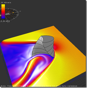

    8 minutes after start:
    20 minutes:

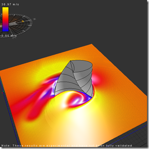

    After about 40 or 50 minutes my simulation started wavering back and forth between this
    and this.

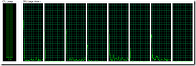

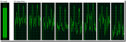

    At which point I say “good enough” and pause the Real-Time Analysis:
    Which allows my processors to go from this:
    to this:
    Whew!

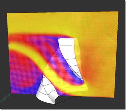

    One quick thing I can do is look at various slices of the data.  If you go to the 2D Grid slice tab, changing the 3d Axis will give you this:
    Now compare that with my nearly immediate results from the 2d analysis’ vertical slice
    You can see that there is certainly a relationship between the 2d and 3d analysis in terms of directionality and relative intensity of the wind velocity. But you can also see some significant differences.  For instance, let’s adjust the Data Display to have the same Minimum/Maximum range displayed:
    Going from an initial range of 0 - 102 m/s, I change the 2D analysis to match my 3d analysis of  0 - 32 m/s
    So this is more of an apple to apples comparison of 2d to 3d:
