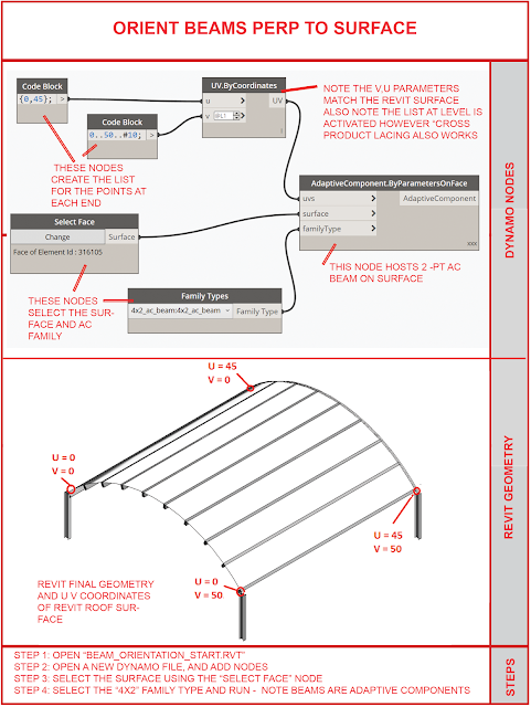

    Simply Complex: Have you ever wanted to orient your beams perp to the surface?
    See the following image and learn how. Also click this link for the sample Revit file. BEAM_ORIENTATION_START.RVT
    Note that Adaptive Component Beams were used for this example for simplicity.
