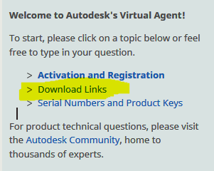

    2. Click Download Links

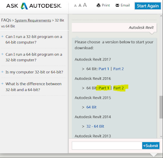

    5. Under Revit 2016, download by clicking Part 1 and Part 2
    6. After download completes, run the file Autodesk_Revit_2016_English_Win_64bit_dlm_001_002. sfx.exe
    During installation, choose to install as a Trial (do not enter serial number).
