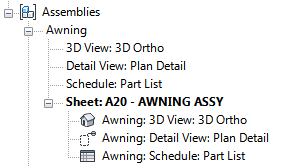

    We will make an Assembly. Here is the help page with a video about it:
    http://wikihelp.autodesk.com/Revit/e...6-Assembli1156

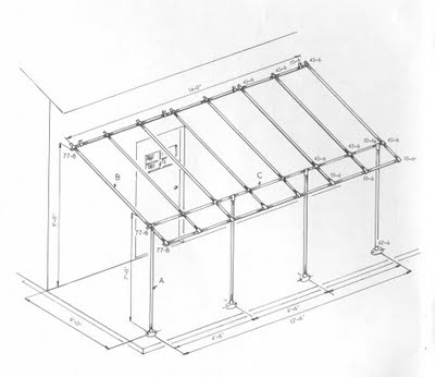

    The inspiration is this awning frame from http://www.simplifiedbuilding.com/projects/awning-frame :

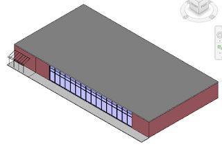

    Let's model a simple building to put it in context. We will model the structure of the frame and at least one connector Family.
    We will make an Assembly which will have its own views for documentation.
    Those views can be arranged on the Assembly's sheet.
    We may have to use some tricks with Parts to get the wall and floor to appear correctly in the Assembly.
