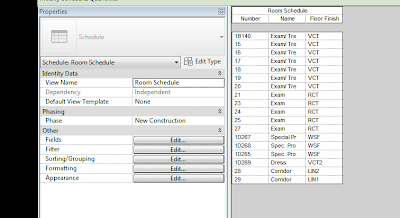

    How to express floor finishes and their transitions parametrically?
    Well, it's easy enough to input the data in a room schedule.
    It's also easy to make a color scheme to see the parameters quickly.

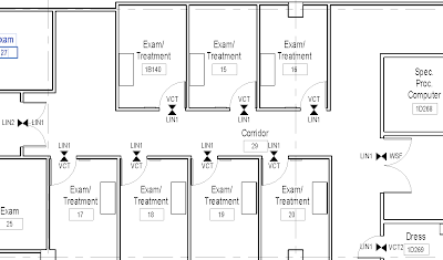

    A trick is to make a Room Tag that has four types with arrows that show floor finish transitions. We'll practice how to do that.
    What about if there is going to be an accent color which will be applied to one wall of a room? Think about it. How could that be shown?
