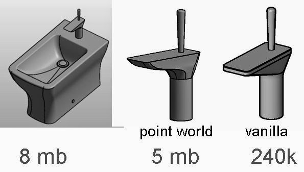

    When I did the Puravida series, the nested taps on the bidet turned out to be very heavy when made in point world. It was an interesting modelling exercise, but I managed something close enough in Vanilla at one twentieth of the size. For a small item like this I think the nurbs version isn't really justified. Cut your losses (or perhaps it's "cut the suit according to the cloth")
    So I ended up with 4vPuravida families weighing in at around 1 to 2mb. That's complete with symbolic plans and elevations, material parameters and chrome fittings, but no connectors as yet. Not being an MEP engineer I rarely get around to adding connectors to my families.
