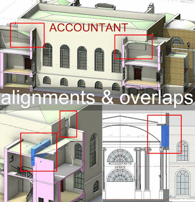

Once again I am trying to resolve alignments, anomalies, overlaps etc as it becomes clearer how the spaces fit together. We may never really know exactly what was built, but my goal is to make it believable, and consistent with work Soane did elsewhere. Sometimes it's just a matter of splitting walls in different places or making slight setbacks to resolve 3-way junctions in a cleaner way. Ultimately I want to be able to tell an interesting story about the history of the Bank and its architects. That's not going to be possible as long as the model remains awkward and incomplete as soon as you stray away from the major spaces that are well documented.

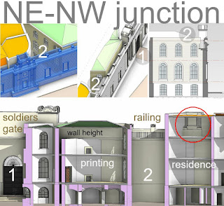

The walkway around the top of the screen wall was modelled with parapet walls on both sides. That is correct in some cases, and I based it on drawings from the archive. But other drawings show it as open to the inside. In fact it seems to be a stone slab cantilevered over those narrow internal yards. My guest is that there was a basic iron railing, which is not showing up on those sketches. That's the interpretation I'm going for anyway, adding railings and supporting the cantilever with a bit of corbelling below.
When we get to Tivoli Corner I have decided to create a flat terrace behind the "attic sentry box" I think that's the only solution that makes any sense. The area is too small and oddly shaped to accommodate a small piece of pitched roof. There are a number of small rooms in the space below that need to be looked at but for the moment I am cleaning up the exterior.

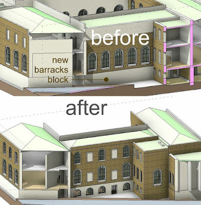

So next we come up to the Soldier's Gate and the yard behind which gave access to Soane's New Barracks Block. Based on my current levels we need a few steps down from the street into the yard, so that's what I'm showing. No corroborating evidence for these though.
The elevation of the new Barracks was a mess. All I have to go on here is the floor plan but I think the solution shown here is a big improvement.
So on we go, heading East down Lothbury we come to another triangle. This is where Princes Street used to terminate before the NW (green) Extension was built. That's the reason for the curved corner. That was the outer edge of the screen wall when Soane first enclosed the properties that were acquired for his NE (orange) Extension. I think that portion probably remained blank after it was incorporated into the site. But the Printing works was new, and needed to get light and air from that side. It's quite scary when you look inside parts of the model that just have been neglected for a year or more. The central decorative feature of the Lothbury screen wall clearly backs into an attic bedroom in the residence court. but has been modelled as if it was open to the world on all four sides. Then there are walls that stop half way up an upper room. I also spent some time adding placeholder fireplaces to these spaces and converting rectangular openings into "real" doors.

I've learnt a lot since Russell built this. Photos and survey drawings show that some of the drawings he used were early design schemes. So there are some small adjustments to be made. I made a start on this, adjusting the niches for example. For the moment I'm just doing what is needed to clean things up at the junctions with the main model.
The toothed stonework shown on some of the window surrounds was taken from site progress sketches. Photos show that the final effect was much simpler. Again there are triangular light courts to elevate and stairs to resolve. Lots of residual spaces to review. You see a semi-circular lobby in plan and place the wall, then a couple of years later think about the ceiling above. Perhaps it should be hemispherical. What a but a lantern? Not sure about that though. Half a lantern? Would he do that?
Russell had a lunette at the West End of the CTO. I think that's based on a Soane archive sketch, but photos show a wide window with a segmental head and 5 divisions. Now that we can see everything in context it becomes clear that a staircase clips the lunette. I guess there's a reason for everything.
That staircase is giving access to Sampson's rear courtyard block which had three floor above ground (plus cellars) This is at the corner where the original Bullion Passage came in from the East. It's fascinating to know my way around this jigsaw puzzle of a building so well, considering it was demolished almost a century ago, and that the passage I just mentioned was moved more than a century before that. I really do feel that this way of studying the past, (getting inside the spirit of a period by way of a BIM authoring package) is immensely powerful and something that more people should be doing.
